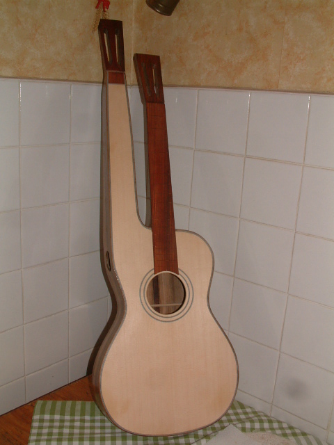

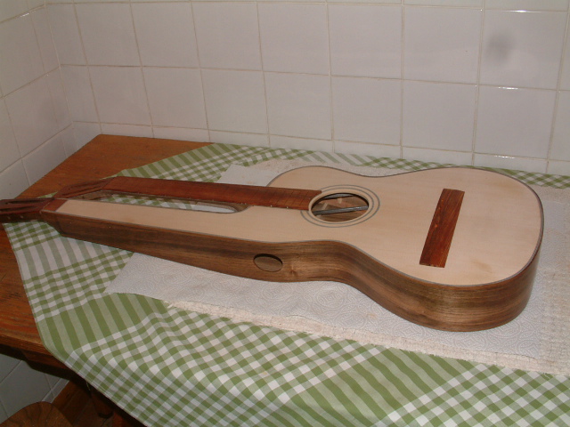

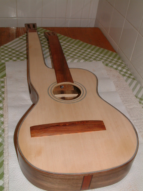

It's got two necks
The main neck is bolted on and now just needs fretting and finishing. This has my version of Mike Doolin's adjustable neck joint. The cocobolo bridge is rough shaped and the bottom is being shaped to match the top. The bridge is way too big at present and will be "steamlined" after I have drilled the 12 bridgepin holes. The back and sides have deen Z-poxied and I start spraying tomorrow:
Another view:
Thanks for looking.

I am interested in those two bars showing through the sound hole. I am assuming they are permanent braces of some sort to hold the upper bout in place against string pressure. Do you do that on your regular guitars as well?

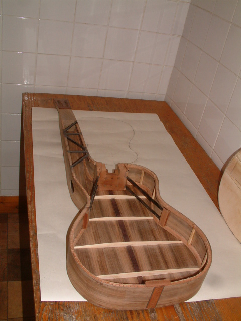

Those are cf flying buttress braces to stabilise the neck block and allow me to float my necks free of the soundboard, and I use them in all of my instruments. I learnt the ideas from the building of Mike Doolin, Rick turner and Howard Klepper. I explain why here on my website. The harp guitar looks like this inside:

Is your neck adjustable? If so does the heel recess into that top block?
PostPosted: Wed Jul 25, 2007 6:09 am
[QUOTE=John K] Thanks for that view!
John,
Yes and yes.

I notice you have installed four fibre rods. I've seen others use only two,fixed at the top of the headblock angled down and fixed to the lower part of the waist area . What's the story ?

I use two pairs as there are two different forces on the neck blok from the string pull. The top of the neck block is being pushed in and the bottom pulled out. So the top cf rods are in compression and the bottom ones in tension. I don't know the physics well enough but think that cf rods going from the top of the neck block to the bottom of the sides will not fully deal with the pull on the bottom of the neck block.
I've read Rick Turner post that he now uses pairs rather than single cf rods.

Could you also tell me why the C.F. rods are orientated the way they are ? i.e. wide side of rod parallel with the sides.
Thanks mate.
Cheers Craig[/QUOTE]
Craig,
Because that's how I have them in the necks I build. I think of them like top and back braces - tall and thin for greater strengh. Plus the side braces that hold the ends would have to be a lot bigger and more weight/bulk. This could be all wrong so I'll wait for those with the "big brains" to chime in
